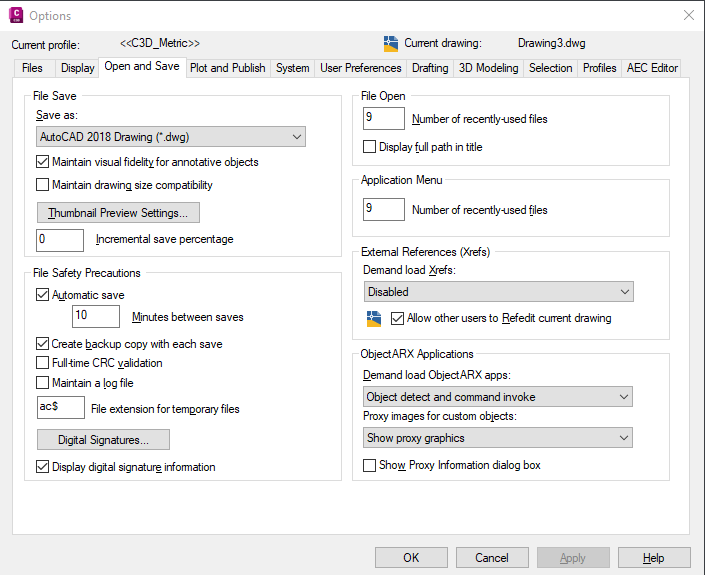

Drawing organization and file safety are an essential pillar of productivity in design and engineering. Having a well-thought-out and organized typical file structure is a must when it comes to keeping your files organized and easy to access for future revisions and coworkers alike.
To help keep your files safe, make sure you’ve set up your Automatic Save settings in AutoCAD! To check your settings, use the OPTIONS command to bring up the drawing options and select the Open and Save tab. Then make sure Automatic save is checked on and choose your save time interval, the default is 10 minutes, but I like to up mine to 20 min. to reduce the interruptions during my work process. Your interval will depend on your risk tolerance and type/size of drawings you work on. You can also change up the file extension name for your temporary save files though I recommend leaving the rest to default.
