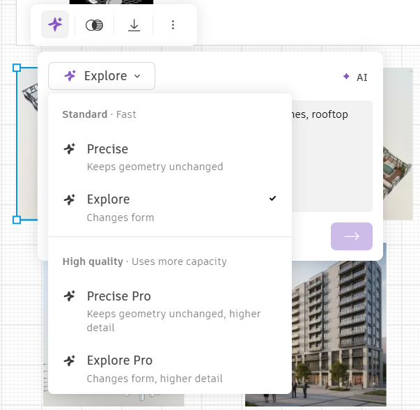

Now it gets interesting that Forma Board now has the AI-powered rendering. You can render any view you extracted from Revit, IFC, or other 3D models in this board. The board can also create a photorealistic rendering from an image in this board.
The prompt has two options: precise and explore. The Precise option will keep geometry unchanged, and Explore will change the form. You can also choose standard or high quality for the two options.
Type the prompt to create a visualization from that view. The process is quite fast, even for the high quality option.
