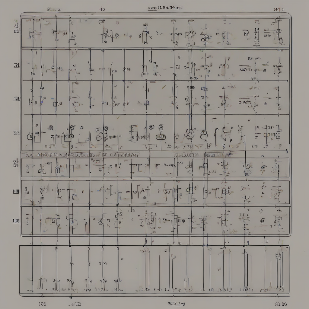

A continuity test performed at the selector pins only verifies the switch contacts themselves. It does not guarantee that the x100 signal propagates without interruption through the entire wiring harness to the PLC input module. The spiral cable of the handwheel is a frequent weak point; internal wire breakage can occur without visible damage. Even if the cable is intact, the specific input channel on the I/O board may have failed, leaving the corresponding X address permanently at a logic low.
Diagnostic approach: Consult the machine electrical schematic to identify the exact X address assigned to the x100 selector position (for example, X0004.2). Using the CNC display, navigate to PMC → PMCDGN → STATUS and enter that address. While rotating the selector to x100, observe the bit state. If it does not transition from 0 to 1, the signal is lost somewhere between the switch contact and the PLC rack—either in the cable, a connector, or the input card itself.
4. Ladder Logic Mapping Error (PMC Programming)
In cases where the machine is newly commissioned, or after a recent PLC firmware update or restoration, the ladder program itself may contain a logical mistake in the translation of the selector input into the standard Fanuc G-code multiplier signals (MP1 and MP2). The usual encoding for x100 on a Fanuc control requires MP1 to be 0 and MP2 to be 1, commonly mapped to bits G19.4 and G19.5. If the ladder erroneously activates both MP1 and MP2, or keeps only MP1 active, the CNC interprets the command as x10.
Troubleshooting step: Access the PMC ladder display on the CNC, locate the network responsible for setting the multiplier bits, and trace the logic conditions that lead to the MP1 and MP2 states when the physical selector is at x100. Anomalies such as an incorrect contact reference, a missing conditional, or a latch that holds the previous state will become evident and can be corrected by editing the ladder or restoring a known-good backup.
